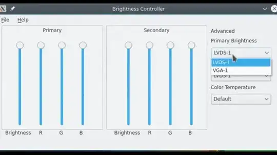

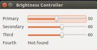

Install Brightness Controller with the following commands:
sudo add-apt-repository ppa:apandada1/brightness-controller
sudo apt update
For Version 2 with Multi Monitor Support and Color Temperature support:
sudo apt install brightness-controller
For Version 1 with up to 4 Monitor Support:
sudo apt install brightness-controller-simple
Brightness Controller Version 1 (Note: Version 1 is not anymore updated)
Note: This does not decrease the intensity of backlight, so won't save your batteries. But you can use this as a last resort to save your eyes. This also works in desktops, where there is no option to control brightness.

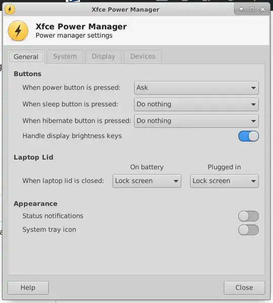

In XFCE, you must enable "Handle display brightness keys" on XFCE Power Manager, under the General tab.
