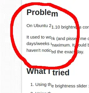

I suspect some display driver problem, as I also noticed some display artefacts lately. When scrolling a web page some parts are scrolling faster than the others, and after 1-2 seconds the display corrects everything.
It's better with an image (I used gimp to simulate what I see) :
Edit : My laptop screen also stays black after closing/reopening the lid, instead of coming back to life... I have to force shut down / restart.
