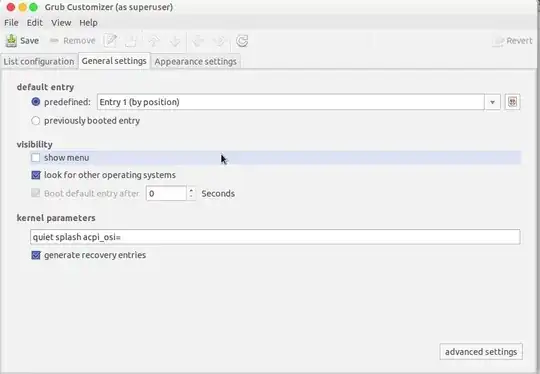

  5. Modify GRUB
    • sudo gedit /etc/default/grub (e.g. leafpad, pluma...)
    • set to GRUB_CMDLINE_LINUX_DEFAULT="quiet splash acpi_osi=" (acpi_osi= did it for me, other options didn't work...)
    • in terminal type sudo update-grub and press Enter
    • or use GRUB customizer:
    sudo add-apt-repository ppa:danielrichter2007/grub-customizer sudo apt-get update sudo apt-get install grub-customizer
Grub customizer
  • press Save in upper left corner, which will update GRUB for you
