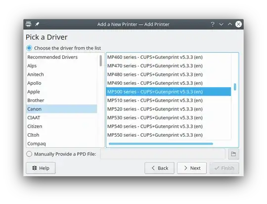

For Ubuntu 20.10:
  1. Install the printer-driver-gutenprint package:
    sudo apt install printer-driver-gutenprint
  2. Open System Settings → Printers, and having selected your printer, the list of drivers should now be a lot more comprehensive!
    Add a New Printer - driver selection (Kubuntu 20.10)
