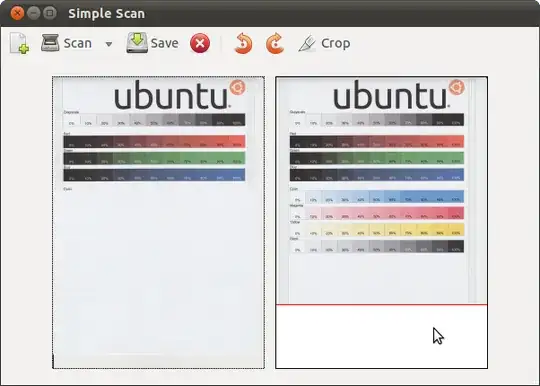

I do not know why, but I can print now -- also wireless.
  • once supplied the PPD from the canon driver source archive, but deleted the printer again as it complained about missing filter
  • tried to compile source as stated above
  • tried to force install of i386 packages as above
  • added the printer once again and it found it as shown in the screenshot below
Even scanning works!
