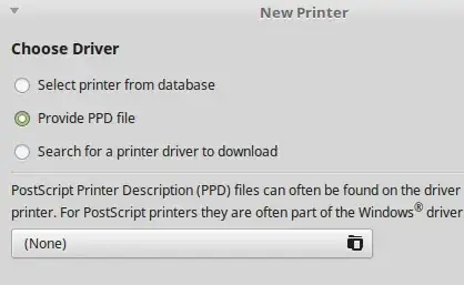

4) open your PRINTERS folder; click the ADD button top-left it should find the G2000; click on till you get to PROVIDE PPD FILE as in photo enter image description here .. so click the NONE box; look for your name at the top; when the dialogue box opens; click the LEFT arrow; to the left of your name; go the left of the HOME button and click the little icon to its left; that enters your file system and then navigate to go into /usr/share/ppd and find the canong2000.ppd you created; enter image description here
