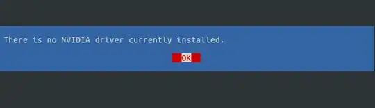

Probably I tried to install them in the past and I think they're going to pollute the system. How can I remove them? I tried to download the propriety and run sudo ./NVIDIA-Linux-x86_64-375.26.run --uninstall but then this message is returned:
Same for 367 and 340. How can I remove them?

There is nothing to remove. Nvidia proprietary drivers are not installed.
You see them because they are available for installation.
