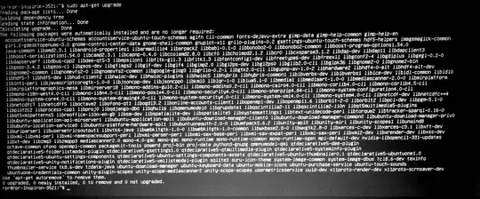

apt-get upgrade results in this:
enter image description here (Click images to enlarge)

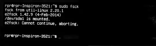

fsck:

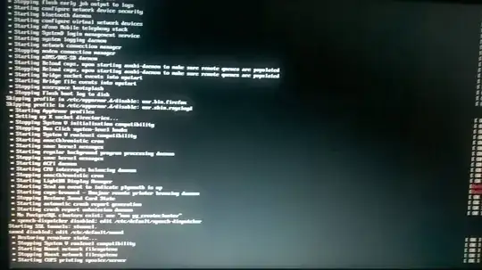

This is the output on pressing Esc:

There was a thread which suggested aptitude install lightdm but when I do that I'm told that all the packages mentioned above (in apt-get upgrade) will be removed and ~500 MB will be freed. So I'm not sure if that's the way to go.
