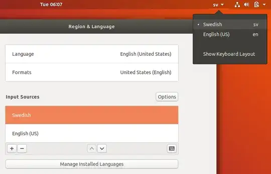

Ubuntu 17.10 and newer (GNOME Shell)
From this answer: After adding the desired languages (by navigating to Settings -> Regional & Language), you can use the default keyboard shortcut which is Super+Space ("super" is another name for the Windows key), or you can click on the top bar menu:
screenshot

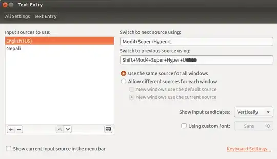

As of Ubuntu 13.10, it is now called Text Entry Settings instead of Keyboard Layout
It can be reached through either of these methods
  1. Going through System Settings -> Text Entry
  2. Using the App Indicator as shown in the screen-shot below.

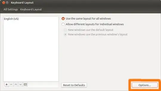

  2. System Settings -> Keyboard Layout -> "+" -> "Hebrew" -> Add

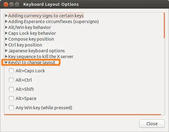

  3. System Settings -> Keyboard Layout -> Options -> Keys to Change Layout -> mark [alt]+[shift] (this step is optional, only if you want that custom keyboard shortcut)

To switch keyboard layout on Ubuntu 12.04
  1. Go to System Settings...
  2. Under Keyboard Layout - click on Options...
  3. Under Key(s) to change layout - choose the combination of keys you would like to use.

In Ubuntu 13.10,
Goto the Keyboard settings window, under Shortcuts tab, I select Typing. The default for Switch to next source is Super+SPACE which didn't seem be working for me and so by clicking on it and I assigned a New Accelerator..., to change to next Layout (I used Super+L).
(Then I assigned something similar for Switch to previous source using the same preferred layout, and then began to test them. Switching from the preferred layout to the alternate worked but the reverse did not. Please refer the next step for the fix.) saucy1
The Fix: After assigning Super+L for "Switch to next source" using my preferred layout (A), I changed my keyboard layout to the alternative layout (B) and then assigned the combination to "Switch to previous source" (for which I used Shift+Super+L). Then I tested them, and they work fine. (Maybe disabling "Switch to previous source" would work too.)
The new accelerators for the key combos that I used looks like this: saucy2
I could then switch to layout (A) using Super+L and back to layout (B) using Shift+Super+L.

I am a totally new to Ubuntu, I just installed it yesterday and I am loving it, but I have encountered the same problem when I was trying to use keyboard shortcuts to switch from Latin to Arabic, but fortunately I found the solution, here is simply what to do:
System Settings... → Keyboard Layout → (click on "+" to Add new Language layouts) → Options... → (click on) "Key(s) to change layout" → (tick) "Left Alt+Left Shift" → Close
