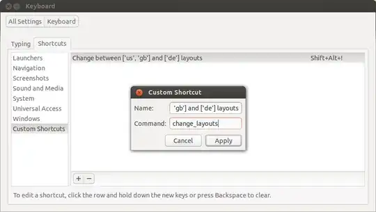

Second, add a custom shortcut for this script. Go to System SettingKeyboardShortcutsCustom Shortcuts and follow the instructions from the below image:
add custom shrtcut
For some reasons, at least in my case, if I set the Alt+Shift shortcut, this will not run the script. Maybe this is a bug. But there are many other choices, like Alt+Shift+1.
