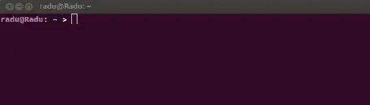

The simple way:
terminal
How I made:
  • I ran ls command in the parent directory where a directory what is named with non-latin characters.
  • With the mouse, I selected the name of the directory (nothing more).
  • I typed cd followed by a Space then I pressed Shift+Insert and, of course Enter(again, nothing more).
If you can't use the mouse, see this quick tutorial.
