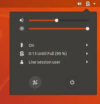

  • Click near the top right corner, select the 'tools' symbol
  • You arrive at the Settings menu. Select Region & Language

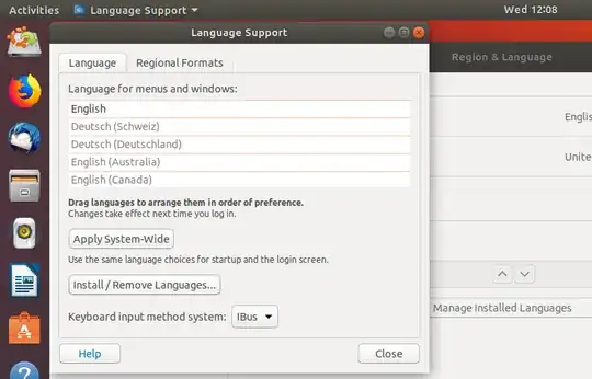

  • Click on the long button Manage Installed Languages
    If the system is new, a window may pop up: 'The language support is not installed completely'. In that case click on Install

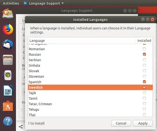

  • Click on Install/Remove Languages
  • Select and tick your language(s), like I did with Swedish
  • Click on Apply

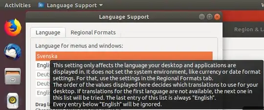

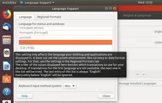

  • Now you might want to select language for menus and windows and drag it to the top of the box
    It should look like this with your language at the top of the box
  • Now you might want to click on Apply System-Wide
  • Close the window 'Language support' and the Settings menu

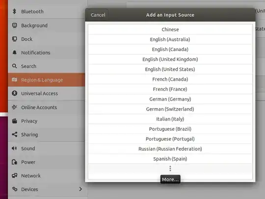

  • Back in the Settings menu, Click on +
  • Mark 'your language' (that you should find directly without clicking on )
  • Click on the green button Add
  • If you do not find your language directly
    • Click on
      screenshot-click on <code>**⋮**</code>
      to get a list with more languages.

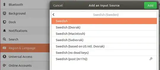

    • Click on 'Other' (it might be slow, so wait a while ...)
    • Select your language from the long list
  • Mark your language in the list
  • Click on ^ to move it to the top of the list
  • Now you can select between English and your language. Click on the applet near the top right corner of the screen.

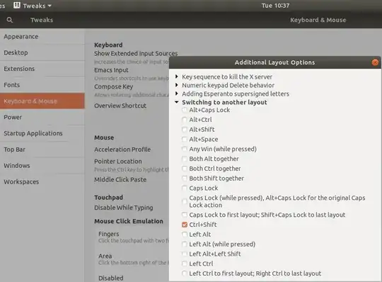

18.04 ctrl+shift to change language
  • On Ubuntu 18.04 LTS with GNOME desktop from GNOME Tweaks.
    1. Install it
      sudo apt-get install gnome-tweaks
    2. Then open GNOME Tweaks (gnome-tweaks).
    3. Select Keyboard & Mouse tab
    4. Click Additional Layout Options button
    5. Expand Switching to another layout
    6. Select Ctrl+Shift here
Right-click and open the screenshot picture in another [big] window to see it in full size. That way it is easier to read the text.
