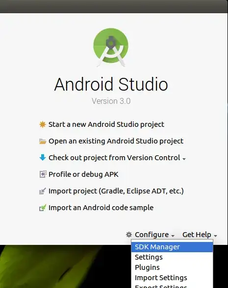

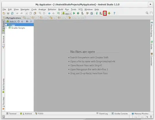

Installing Android SDK (if necessary)
  1. Click the marked button
  2. Get the latest SDK tools

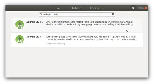

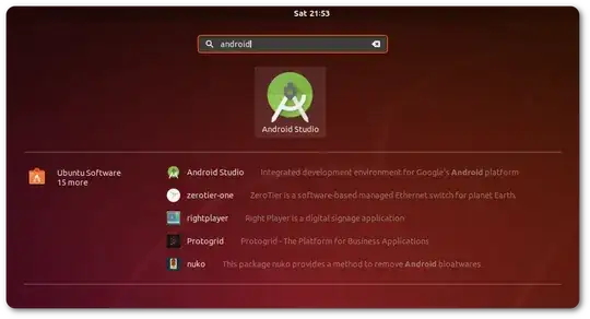

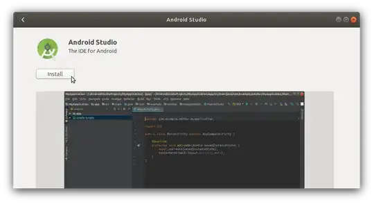

The easiest method to install Android Studio on Ubuntu is to just use the snap package from Ubuntu Software store. No need to download Android Studio as zip, try to manually install it, run umake and other scripts, add PPAs or fiddle with Java installation. This snap package bundles the latest Android Studio along with OpenJDK and all the necessary dependencies. Neat and clean!
Step 1: Install Android Studio
Search "android studio" in Ubuntu Software, select the first entry that shows up and install it:
Search Android Studio on Ubuntu Software Android Studio on Ubuntu Software

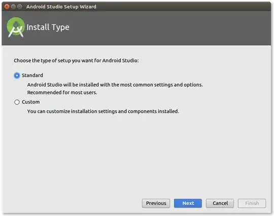

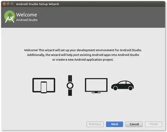

The Setup Wizard'll guide you through installation:
Android Studio Setup Wizard
Select Standard install to get the latest SDK and Custom in-case you wanna change the SDK version or its install location. From here on, it's pretty straightforward, just click next-next and you'll have the SDK downloaded and installed.
Select Standard or Custom installation

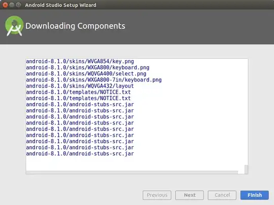

Now follow setup wizard instructions. Eventually you will hit Downloading Components window. It may take for a while until required components are installed. As we took care about all required libraries and software from very beginning (part 2), this process should be finished without any error.
Downloading Android SDK
Upon first launch Android Studio installs only latest SDK platform (at the time of writing API 27). To make your toolset viable, you need at least 2-3 more older SDK platforms installed (here you can find the dashboard showing actual demand for different APIs version). In order to get them, from the Android Studio welcoming screen, click “Configure” and choose the SDK Manager option.
Android SDK option
From here you can choose whatever you need to develop Android apps. P.S. You can actually install everything from the list (even obsolete packages), but it will take ages to download.

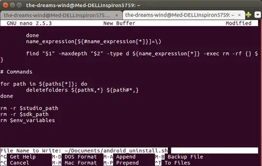

For those who not familiar with the notion of shell scripts, here are simple steps that should help:
  1. Open terminal, write command nano. A nano editor will be opened in terminal window.
  2. Copy the text from the script above and past it in the terminal window with nano opened (Ctrl+Shift+V)
  3. Click Ctrl+O in order to save file, choose the path and name of the file with .sh extension:
    Uninstall script
  4. Exit the nano (ctrl+X)

Android Studio is available as a snap package in all currently supported versions of Ubuntu. The Android Studio snap package was the 5th most popular snap package in 2018. To install it open the terminal and type:
sudo snap install android-studio --classic
Android Studio provides the fastest tools for building apps on every type of Android device.
World-class code editing, debugging, performance tooling, a flexible build system, and an instant build/deploy system all allow you to focus on building unique and high quality apps.
System Requirements for Android Studio
  • 8 GB RAM recommended; plus 1 GB for the Android Emulator
  • 2 GB of available disk space minimum, 4 GB recommended

To create a desktop entry:
Go to Android Studio > Tools > Create desktop Entry

Setting up Android Studio takes just a few clicks. (You should have already downloaded Android Studio.)
To install Android Studio on Linux, proceed as follows:
  1. Unpack the .zip file you downloaded to an appropriate location for your applications, such as within /usr/local/ for your user profile, or /opt/ for shared users.
  2. To launch Android Studio, open a terminal, navigate to the android-studio/bin/ directory, and execute studio.sh.
  3. Select whether you want to import previous Android Studio settings or not, then click OK.
  4. The Android Studio Setup Wizard guides you though the rest of the setup, which includes downloading Android SDK components that are required for development.
Tip: To make Android Studio available in your list of applications, select Tools > Create Desktop Entry from the Android Studio menu bar.
