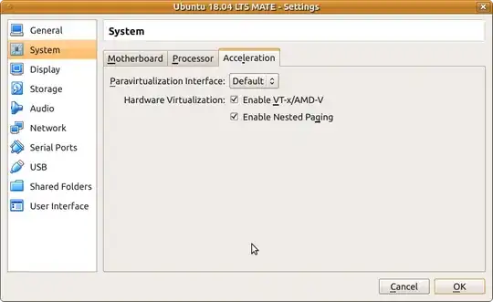

If you have problems with VirtualBox - ensure that you have set correct Settings for virtual machine: open System, select Acceleration tab and check that you have correct settings:
  • Paravirtualization Interface: Default
  • Hardware Virtualization: ☑ Enable VT-x/AMD-v, ☑ Enable Nested Paging
    VirtualBox - System - Acceleration

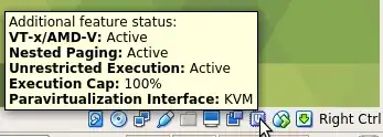

This will result in blue V (V on CPU) on CPU icon in status bar of VirtualBox machine window (see yellow hint below for details - machine uses KVM) :
VirtualBox status bar
