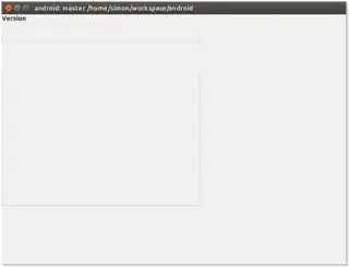

However, this causes git-cola to break:
$ git-cola
QNativeImage: Unable to attach to shared memory segment.
(python:13321): Gdk-WARNING **: shmget failed: error 28 (No space left on device)
X Error: BadDrawable (invalid Pixmap or Window parameter) 9
  Major opcode: 62 (X_CopyArea)
  Resource id:  0x0
  Resource id:  0x0
  Resource id:  0x0
causing this visual experience:
