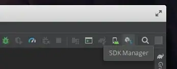

Once you have it, you can start it up and open SDK Manager in the top right corner:
SDK Manager
Now download the SDK versions you want to target. Be sure to also install NDK, though, as that's what we will need to deploy Xamarin applications. Then you can try building an sample app and deploying it to your phone (or to a running emulator) just to make sure everything works all right.
