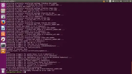

i tried to install android studio using repository method but when it finished downloading i got this error shown in the image below . Android Studio is saved in /opt folder
Download Android Studio from this page: http://tools.android.com/download/studio/builds/android-studio-2-2-stable
Unpack the archive and run studio.sh in bin folder.
There's always a path to create desktop shortcut: How to add Android Studio to the launcher?
If you need to move this folder to /opt folder just use bash commands or run nautilus with sudo su privillages
