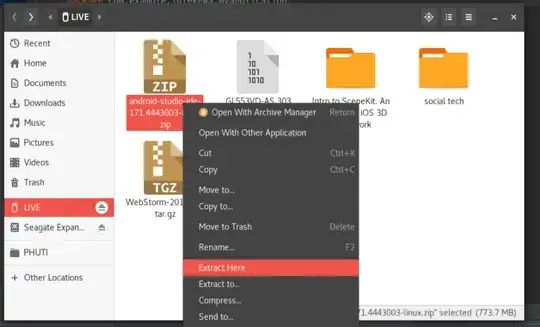

Go to Download Android Studio and download the zip file, extract the files.
extract files

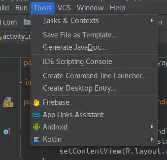

After launching android studio create a desktop entry by clicking Tool > Create Desktop Entry

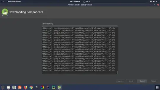

When you launch android studio for the first time, it will download some components. enter image description here
