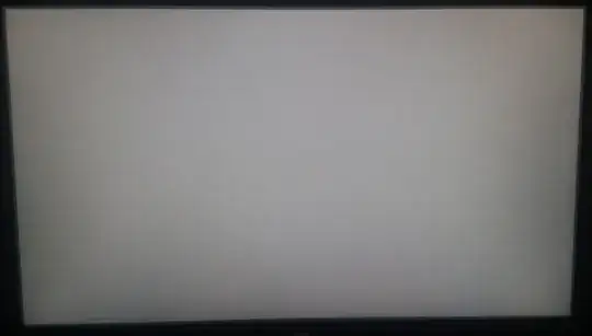

On every boot up I get this:
grey screen
For about 10 seconds (or more) before the "normal" Ubuntu Gnome loading screen and the login screen comes up.
I've read some questions and a bug report about this already, but this problem was dismissed as a minor inconvenience or there were no real solutions (that worked for me). For me, this problem leads to an unacceptable slow boot compared to Ubuntu (Unity) or Windows.
Does anybody know how to fix this or is this a "feature" of Ubuntu Gnome and not a bug?
