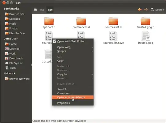

To be able to edit files with root privileges directly from the standard file browser, Nautilus, install nautilus-gksu. This will add a "Open as administrator" entry to the context (right click) menu in Nautilus.
To install, in a terminal, type
sudo apt-get install nautilus-gksu
To get the entry to show in 11.10 also run
sudo cp /usr/lib/nautilus/extensions-2.0/libnautilus-gksu.so /usr/lib/nautilus/extensions-3.0/
Then log out and in again, and go to the sources.list file in Nautilus. Right click it, choose "Open as Administrator", authenticate and the text file will open in gedit with superuser rights.
