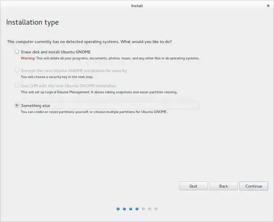

When the installation arrives at Installation Type screen, select Something else something else
Now, on the next screen

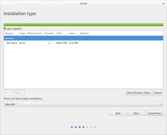

Select the appropriate drive, the one you want to install the OS on with the 128GB or roughly estimated at 131072MB. This might be /dev/sda
select-disk

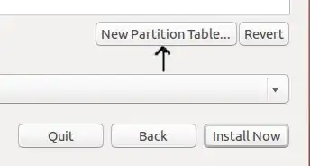

We are going to be creating three partitions. BIOS, / (root) and swap Select create new partition table... (option in the bottom left)
new partition table

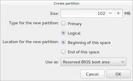

Partition 1 bios_grub
Select the free space and create the first partition which is the BIOS by clicking on the plus (+) button on the far left, horizontal to new partition table.
Your options for this partition should match the screen-shot below and click OK
bios partition

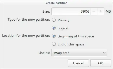

Partition 2 swap
Swap is a controversial topic. However the amount of swap should be given on the premises of whether of not you're gonna be hibernating your pc. If you are going to hibernate, swap should be the size of RAM else 4GB (4096MB) should be fine. Choose accordingly and OK again.
swap-allocation

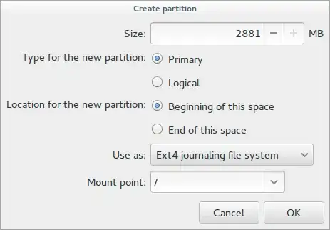

Partition 3 / (root)
Basic: Give Root Partition Remaining Space
Advanced: Create a separate /home partition for personal files.
Recommended root for Disk Space available, 30GB Give /home rest.
Follow snip below for root or alternate for /home partition
root

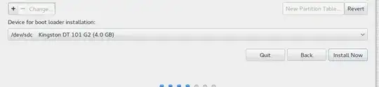

Select 128GB SSD to house boot loader grub
