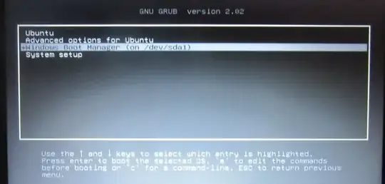

But now I can no longer boot into Windows. What I get first is the grub loader, as usual:

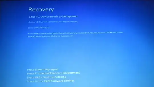

Booting into Ubuntu from here works fine. But if I pick Windows Boot Manager option however, I get this:
And none of the options lead anywhere. (Either you end up back in the grub menu. Or in regular BIOS settings.)

One suspect
On a prior attempt (full fresh install) I noticed an abnormaly in partition numbering. I did sda 1-6 with gparted as pictured above.
When running the Windows System Install (Bootstick) and took the built in partition chooser/editor, it looked like this:
Drive 0 Partition 1:  512 MB   Type: System
Drive 0 Partition 2:  16 MB    MSR
Drive 0 Partition 3:  366 GB   Primary <-- that is sda5 !!
Drive 0 Partition 4:  4 GB     Primary
Drive 0 Partition 5:  76 GB    Primary <-- taht is sda3 !!
I could clearly tell this mistake by volume size.
So, to go along and reduce Windows' choice, I deleted Partition 3 to 5, just create a 80 (or 76) GB one instead and did the windows install. Which then worked correct.
Thereafter the Ubuntu bootstick for installing, I added Partition 4-6 back in. But perhaps precisely that made Windows “rethink” its odd partition numbering and it is now pointing to the wrong place? So the Windows ESP entry tries to run Windows from drive 0 partition 3 which by its own odd conception is sda5(?)
So the fix might be outside Grub in the Windows-information on the ESP drive? So I have to fix the how-to-boot-Windows information on the ESP, apparently known as BCD? (wild ass guess)
