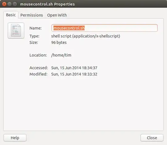

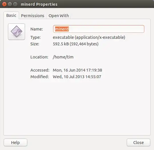

Here is a screenshot of what I see when I right click then go on properties. The file first:
properties of executable file
And the shell script here:
properties of shell script

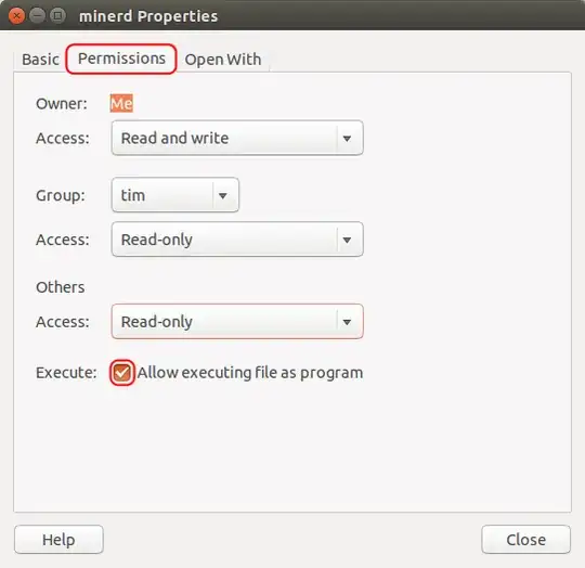

There are two ways of making a file executable:
GUI Method:
Go to the permissions tab, then tick the box Execute: [✓] Allow executing file as program.
