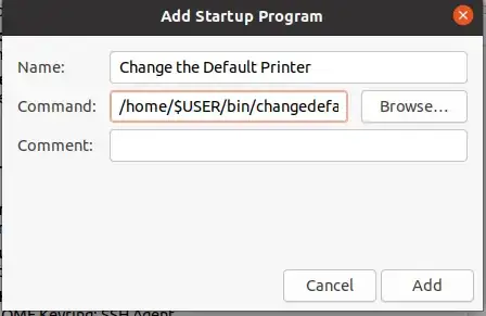

Make the script run when you login to the laptop
Open the application "Startup Application Preferences" and click on the button Add
Add a sensible name of the script so that you know what it does, and the location of the script as:
/home/$USER/bin/changedefaultprinter.sh
Where $USER is your username.
Click the Add to save the changes and close the "Startup Application Preferences" window. From now on every time you login to your laptop this script will run. It will determine which WiFi you are on and change the default printer.
