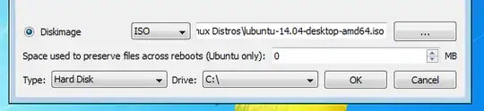

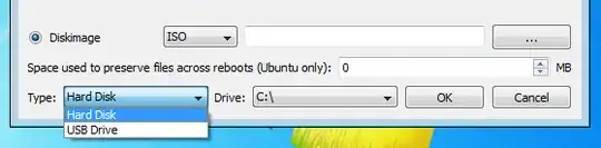

  3. Now, from the drop-down menu under Type: select Hard Disk.
    Hard Disk
  4. Next select the Diskimage. Browse to the directory where you downloaded the iso file of Ubuntu.
    ISO
  5. Press OK.

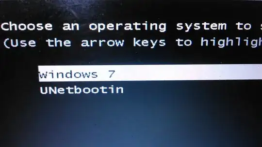

  6. Next when you reboot, you will get a menu like this:
    Unetbootin
  7. Select Unetbootin and you will get the "Try" or "Install" option there.
  8. Finally, you can install your version of Ubuntu alongside Windows.

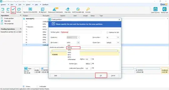

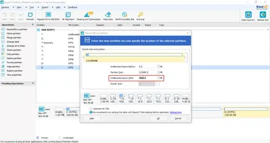

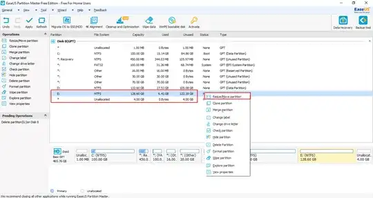

    8. Download EaseUS Partition Master Free and run it.
    9. Select your last partition.
    10. Right-click on it and from the context menu select Resize/Move partition.

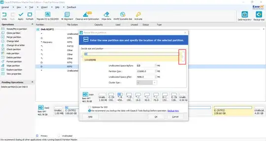

    11. From the size shown beside Partition Size minus 4096 MB (to mimic a 4GB pendrive).
    12. Press tab and the rest will be auto-completed.
    13. Select the newly created partition and right-click on it. Select Create Partition from context menu.
    14. In this window, select FAT32 as the File System. Click on OK. Finally, click on Apply (present at the top-left of the window).
      10
    15. Next, extract Ubuntu iso to this partition and finally reboot.

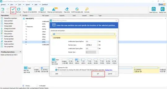

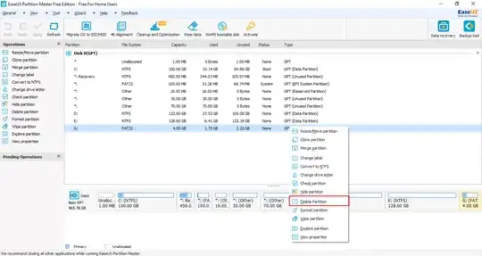

    17. Run EaseUS Partition Master Free again.
    18. Right-click on the 4 GB partition and from the context menu select Delete Partition.
      11

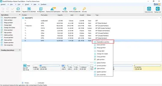

    19. Right-click on the partition above the Unallocated partition and select Resize/Move Partition from the context menu.
      12
    20. Extend the bar to the extreme right by dragging the button.
      13
    21. Click on OK. Finally, click on Apply (present at the top-left of the window).

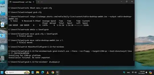

This answer will explain how to use Windows CMD to boot from the Ubuntu ISO file in the C partition without needing a USB flash drive or creating another partition.
The steps:
  1. Install sudo for Windows (this step is optional)
  2. Create a grub menu
  3. Download the Ubuntu ISO file
  4. Download grub-2.12 for Windows
  5. Install grub
  6. Reboot to use Ubuntu live system
Using Windows CMD, notepad and the sudo command to boot from the Ubuntu ISO file located in the C partition (without USB or another partition)

  1. Download the Ubuntu ISO file
In Windows cmd and apply this command:
curl https://cdimage.ubuntu.com/noble/daily-live/current/noble-desktop-amd64.iso --output noble-desktop-amd64.iso
You can choose another Ubuntu ISO file but correct the link and the file name in the last command and grub menu entry.
When the ISO file is downloaded, move grub.cfg to /boot/grub and the Ubuntu ISO file to the root of the C partition In Windows cmd and apply these commands:
sudo mkdir c:\boot\grub
sudo move grub.cfg c:\boot\grub\
sudo move noble-desktop-amd64.iso c:\
  1. Download grub-2.12 for Windows
curl https://ftp.gnu.org/gnu/grub/grub-2.12-for-windows.zip --output grub-2.12-for-windows.zip
When the download is finished, extract the zip file
tar -xf grub-2.12-for-windows.zip
  1. Install grub
First, make sure that the C:\boot directory exists and is not hidden. if it exists and isn't hidden, go on
cd %UserProfile%\grub-2.12-for-windows
To install Grub2 for BIOS, type or copy the following, (replacing X with your drive letter and # your Disk number), and then press Enter.
sudo grub-install.exe --force --no-floppy --target=i386-pc --boot-directory=X:\boot //./PHYSICALDRIVE#
in my case, I used this command:
sudo grub-install.exe --force --no-floppy --target=i386-pc --boot-directory=C:\boot //./PHYSICALDRIVE0
To install Grub2 for UEFI 32-bit or 64-bit, see this guide.
If the C:\boot directory is hidden or does not exist, use this command instead of the last one:
grub-install.exe --force --no-floppy --target=i386-pc --boot-directory=X:\  //./PHYSICALDRIVE#
(replacing X with your drive letter and # your Disk number), and then press Enter. in this case, you must move the grub.cfg to the /grub directory instead of the /boot/grub directory.
When grub is installed successfully, reboot to boot by the Ubuntu live system
shutdown /r
steps of using Windows CMD, notepad and the sudo command to boot from the Ubuntu ISO file located in the C partition (without USB or another partition)
Boot with live Ubuntu session and Ubuntu partition from Windows without a USB and without installing grub
