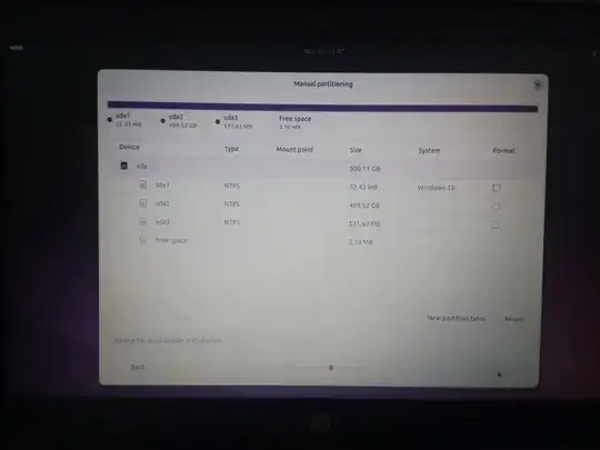

I am new to Linux and trying to install Ubuntu 24.04 on my laptop alongside Windows 10. It only shows the manual partitioning option which requires me to partition the disk which I don't know how to do properly. I'm unable to follow tutorials probably because they were written years ago.
Manual partitioning screen of the Ubuntu 24.04 installer:
image of partitions while installing Ubuntu
I need help on how to get Ubuntu to let me install it alongside Windows or just delete Windows and install Ubuntu. (It's a new Windows with literally nothing).
I want to add that I am installing Ubuntu using UNetbootin as described here (How can I install Ubuntu without CD and USB?) and not with a bootable USB.
Bitlocker is disabled, but the issue persists.
