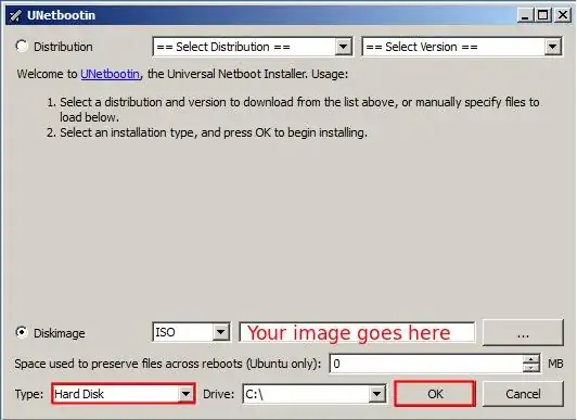

  1. Download Unetbootin from here.
  2. Run Unetbootin.
  3. From the drop down menu under Type: select Hard Disk
  4. Next select the Diskimage. Browse to the directory where you downloaded the iso file. Unetbootin Interface
  5. Press OK.

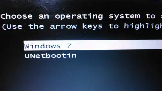

  6. Now restart your computer. Select Unetbootin when the menu appears where it shows your operating system. It should look something like this: BIOS Unetbotin
  7. Afterwards, simply proceed with the installation as normally.
  8. Now you should be able to install Ubuntu without a USB or a CD.
