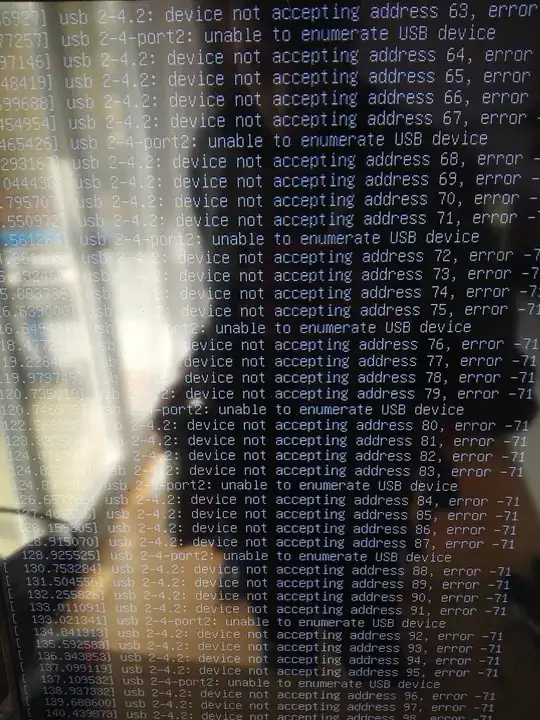

First I tried to create a bootable USB drive, to test Ubuntu, and then install it. While creating the bootable drive went just fine , but booting from it didn't:

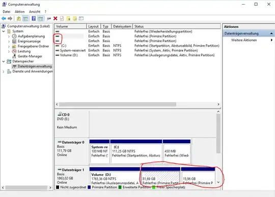

So I booted Windows, to see if Ubuntu had taken up the previously unallocated space of 100 GB. The stuff I marked with red was previously 100 GB of unallocated space. Now it's 2 partitions that I can't access with Windows, so Ubuntu must be installed on there, right?
If I'm not wrong, that means Ubuntu is actually installed, I just can't boot to it for some reason. I have been looking through the boot options on my motherboard, but can't find an option to boot to ubuntu. But I found out that my printer is listed as a boot option lol.
