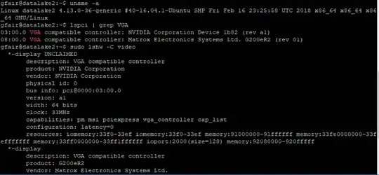

So I used prime-select intel and removed the modeset=0 blacklist to get to a working desktop. So below is a review of my current status:
Nvidia card is seen by lspci
$ uname -a
Linux datalake2 4.13.0-36-generic #40~16.04.1-Ubuntu SMP Fri Feb 16 23:25:58 UTC 2018 x86_64 x86_64 x86_64 GNU/Linux
$ lspci | grep VGA
03:00.0 VGA compatible controller: NVIDIA Corporation Device 1b82 (rev a1)
08:00.0 VGA compatible controller: Matrox Electronics Systems Ltd. G200eR2 (rev 01)
$ sudo lshw -C video
  *-display UNCLAIMED
       description: VGA compatible controller
       product: NVIDIA Corporation
       vendor: NVIDIA Corporation
       physical id: 0
       bus info: pci@0000:03:00.0
       version: a1
       width: 64 bits
       clock: 33MHz
       capabilities: pm msi pciexpress vga_controller cap_list
       configuration: latency=0
       resources: iomemory:33f0-33ef iomemory:33f0-33ef memory:91000000-91ffffff memory:33fe0000000-33fefffffff memory:33ff0000000-33ff1ffffff ioport:2000(size=128) memory:92080000-920fffff

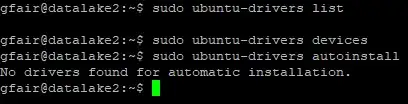

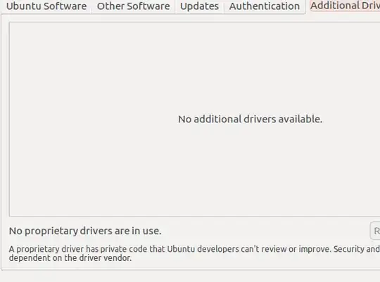

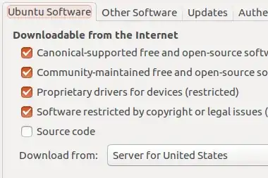

My second problem seems to be that ubuntu is unable to recognize the need for drivers for my card, even-though I have enabled restricted propitiatory drivers. no drivers
sudo software-properties-gtk gives me nothing as well.
No drivers Restricted Enabled

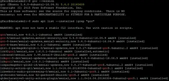

My gcc version: enter image description here
