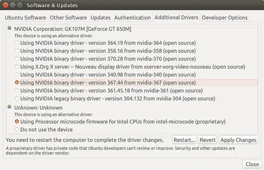

In Ubuntu you can get more up-to-date Nvidia drivers (than your #340) from System Settings, Software & Updates, Additional Drivers:
Additional Drivers
Going to this screen first is probably your best bet with Ubuntu 16.04. Many of these drivers are tested by the Ubuntu team which may not be a 100% guarantee does offer greater peace of mind. I'm not sure why the Nvidia drivers are listed as open source because last time I looked they were marked as proprietary.

Edit 1 - Tried Nvidia Driver 367.44 on my laptop
After posting the answer I went back into Additional Drivers and the Nvidia drivers were in a different order with 367.44 at the bottom. I clicked the Apply button and it took about 5 minutes to install the drivers. Then I clicked the Restart button.
Upon boot I got a blank screen with a frozen cursor at the top. Apparently it happened to lots of others and the solution is to reboot and enter e in the grub menu. Find the line with "quiet splash" and add the parameter nomodeset and press F10 to continue booting.
