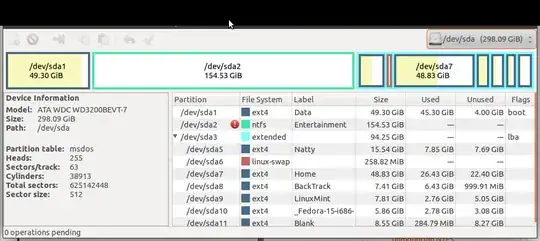

MY NTFS Partition has gotten corrupt somehow (it's a relic from the days when I had Windows installed).
GParted screenshot showing different partitions

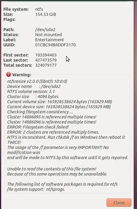

When I open gparted (using live CD), I get an exclamation next to my NTFS drive which states GParted Screenshot showing error
Is there a way to run chkdsk without using windows ?
