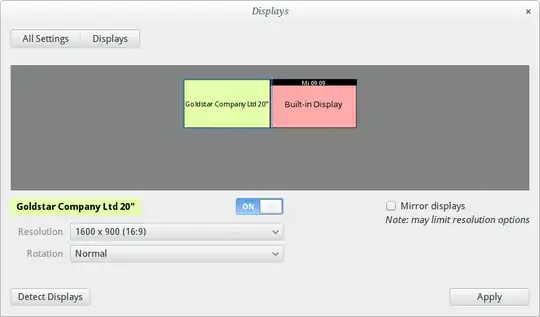

I've installed gnome in my new 14.04 (not the Ubuntu-Gnome distribution). I've noticed the title bars are huge though, and I would like to change.
The things is that this solution from here is not available for me:
  1. Go to System Settings.
  2. Go to Displays.
  3. Go to "Scale for menu and title bars."
  4. Drag the slider to your preferred size.
Is there somewhere else I could change this? I looked in gnome-tweak-tool and also ubuntu-tweak-tool without success.
This is my display windows and, as you can see, there is no scale option. This is my display windows and, as you can see, there is no scale option.
