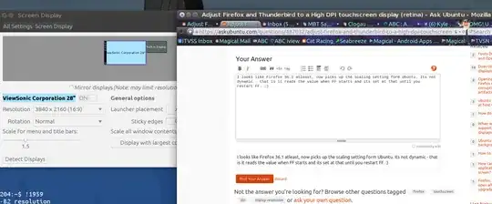

I looks like Firefox 36.1 atleast, now picks up the scaling setting form Ubuntu. Its not dynamic - that is it reads the value when FF starts and its set at that until you restart FF. :)enter image description here
