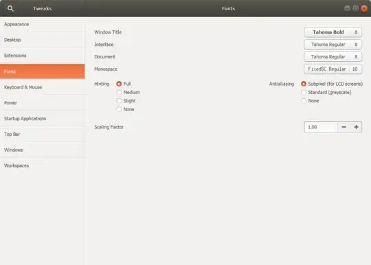

Since "upgrading" to Ubuntu 17.10, I found I had to use gnome-tweak-tool to get some settings the way I want them.
Once I find a setting in the gnome-tweak-tool GUI, how can I figure out its scriptable translation?
For example the following gsettings lines match the relevant entries in the gnome-tweak-tool screen shot below...
gsettings set org.gnome.desktop.wm.preferences titlebar-font "Tahoma Bold 8"
gsettings set org.gnome.desktop.interface font-name "Tahoma 8"
gsettings set org.gnome.desktop.interface document-font-name "Tahoma 8"
gsettings set org.gnome.desktop.interface monospace-font-name "FixedSC 10"
screen shot from gnome-tweak-tool ...but how could anyone guess that? And how would I, for example, figure out where to get the corresponding settings for hinting and antialiasing?

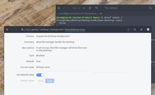

Easily find out what is being set
Instead of searching through a whole directory of options:
  1. Open a terminal window
  2. Run the command:
    dconf watch /
  3. Make your changes and see what the terminal shows:
    ...and there you are.
Dconf & gsettings
In the example, you see the output from dconf. Gsettings is the cli- frontend to dconf. Many times, you can use both a dconf command or a gsettings command. In this case either:
dconf write /org/gnome/desktop/background/show-desktop-icons false
or:
gsettings set org.gnome.desktop.background show-desktop-icons false
If the gsettings key exists however, the latter is considered to be better practice, to protect the integrity of your dconf database.
See also here and here.

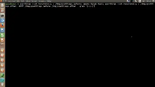

For most of the settings you can use this approach:
  • Export the list of gsettings into a temporary file:
    gsettings list-recursively > /tmp/gsettings.before
  • Make your changes by gnome-tweak-tool (or unity-control-center);
  • Export the list of gsettings into an another temporary file:
    gsettings list-recursively > /tmp/gsettings.after
  • Compare the two files (.before and .after) and get the differences:
    diff /tmp/gsettings.before /tmp/gsettings.after | grep '[>|<]'
    Or compare and get only the new values (source):
    diff /tmp/gsettings.before /tmp/gsettings.after | grep -Po '> \K.*'
    Or compare and get only the new values, but replace the beginning of the lines with gsettings set to prepare a list of commands, that cold be stored directly within your script file (source):
    diff /tmp/gsettings.before /tmp/gsettings.after | sed 's/>/gsettings set/;tx;d;:x'
You can run all these commands from one line (or you can create a script to automate the process):
gsettings list-recursively > /tmp/gsettings.before; gnome-tweak-tool; gsettings list-recursively > /tmp/gsettings.after; diff /tmp/gsettings.before /tmp/gsettings.after | grep '[>|<]'
The next demo is created within Ubuntu 16.04. I think the approach shall work also within 17.10:
