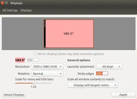

You can find out where the setting is changed if you open a terminal:
gsettings list-recursively > /tmp/before
echo 'Now unity-control-center should open. Please change the scaling in "Displays" and close.'
gsettings list-recursively > /tmp/after
diff /tmp/before /tmp/after | grep '[>|<]'
Copy and paste the above lines into a terminal. These command will create two temp files - before and after the change of the scale factor. Press Enter after you close Unity Control Center to execute the last line, that will compare these two temp files.
In my system when I change the scale factor from 1 to 1.5 the output of the above is:
< org.gnome.desktop.interface text-scaling-factor 1.0
> org.gnome.desktop.interface text-scaling-factor 1.5
< org.gnome.desktop.interface cursor-size 24
> org.gnome.desktop.interface cursor-size 36
< com.ubuntu.user-interface scale-factor {'VGA-1': 8, 'HDMI-0': 8, 'HDMI-1': 8}
> com.ubuntu.user-interface scale-factor {'VGA-1': 8, 'HDMI-0': 8, 'HDMI-1': 12}
So the new values are:
I've recorded the values when the scaling factor is 1, 1.25 and 1.5.

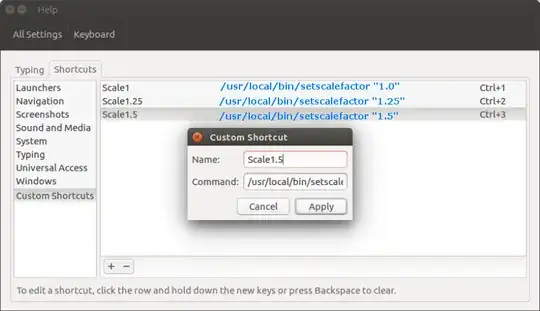

Next step is to create this scrip accessible via shortcut key combination. Go to: Unity Control Center (System Settings) > Keyboard > Shortcuts > Custom Shortcuts. Then create your custom shortcuts, like as the image:

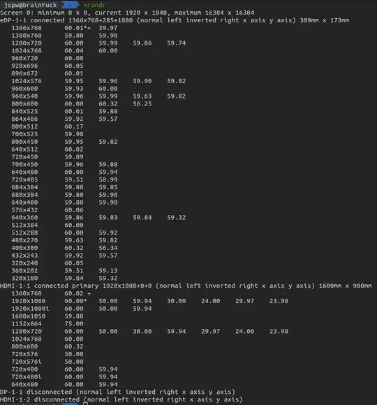

Use below command to check the display Pannel interface name :
xrandr
Then to scale :
xrandr --output HDMI-1-1 --scale 1x1
here HDMI-1-1 is my display pannel interface as i am connected with my second display through a hdmi port.
You have to take a look at xrandr. I say it's the tool of choice.
Edit: xrandr --output "output_name" --scale 0.9x0.9
See more examples with: man xrandr
