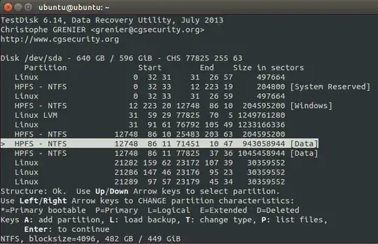

At the Testdisk phase I have this:
Testdisk

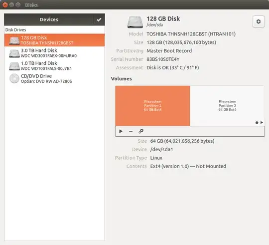

3) determine what your source (old) drive is named This is likely /dev/sda but to be sure look with Disks from the GUI in the attached image below you can see my sda1 is a 128GB drive with 2 64GB partitions.
Recovery1
4) attach the new drive Verify the device names with Disks from the GUI make notes! The old disk will be called source and the new one called target. So in this example source=/dev/sda and target will be /dev/sdb or whatever it says it is in Disks

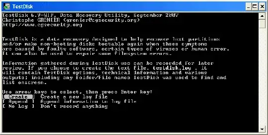

Log creation Create Log
Choose Create to instruct Testdisk to create a log file containing technical information and messages, unless you have a reason to append data to the log or you execute TestDisk from read only media and must create the log elsewhere.
Choose None if you do not want messages and details of the process to be written into a log file (useful if for example Testdisk was started from a read-only location).
Press Enter to proceed.

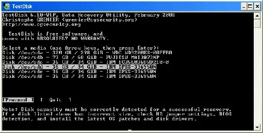

Disk selection
All hard drives should be detected and listed with the correct size by TestDisk: disk selection
Use up/down arrow keys to select your hard drive with the lost partition/s.
Press Enter to Proceed.

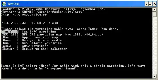

Partition table type selection
TestDisk displays the partition table types. menu partition table type
Select the partition table type - usually the default value is the correct one as TestDisk auto-detects the partition table type.

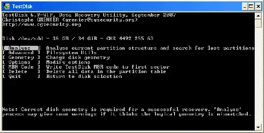

Current partition table status
TestDisk displays the menus (also see TestDisk Menu Items). menus
Use the default menu "Analyse" to check your current partition structure and search for lost partitions.
Confirm at Analyse with Enter to proceed.

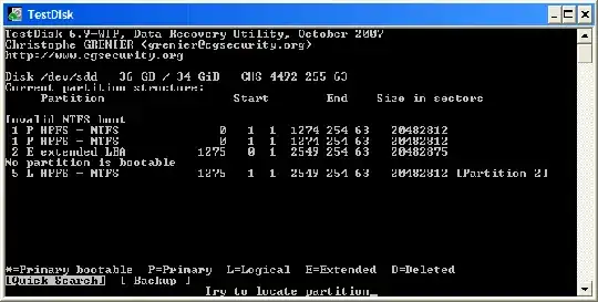

Now, your current partition structure is listed. Examine your current partition structure for missing partitions and errors. Analyse
The first partition is listed twice which points to a corrupted partition or an invalid partition table entry. Invalid NTFS boot points to a faulty NTFS boot sector, so it's a corrupted filesystem. Only one logical partition (label Partition 2) is available in the extended partition. One logical partition is missing.
Confirm at Quick Search to proceed.

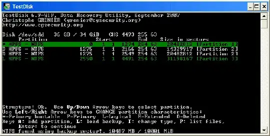

Since a partition, the first one, is still missing, highlight the menu Deeper Search (if not done automatically already) and press Enter to proceed.
A partition is still missing: Deeper Search
Deeper Search will also search for FAT32 backup boot sector, NTFS backup boot superblock, ext2/ext3 backup superblock to detect more partitions, it will scan each cylinder
After the Deeper Search, the results are displayed as follows: The first partition "Partition 1" was found by using backup boot sector. In the last line of your display, you can read the message "NTFS found using backup sector!" and the size of your partition. The "partition 2" is displayed twice with different size. Partitions listed as D(eleted) will not be recovered if you let them listed as deleted. Both partitions are listed with status D for deleted, because they overlap each other. You need to identify which partition to recover. results deeper search!

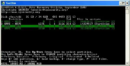

Highlight the first partition Partition 2 and press p to list its data.
The file system of the upper logical partition (label Partition 2) is damaged

Let this partition Partition 2 with a damaged file system marked as D(deleted).

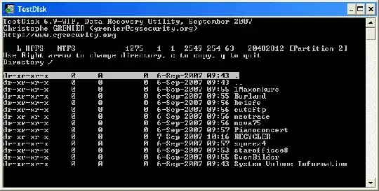

Highlight the second partition Partition 2 below
Press p to list its files.
list files
It works, your files are listed, you have found the correct partition!
Use the left/right arrow to navigate into your folders and watch your files for more verification
Note: FAT directory listing is limited to 10 clusters - some files may not appear but it doesn't affect recovery.
Press q for Quit to go back to the previous display.

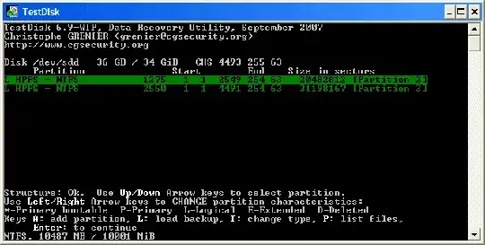

The available status are Primary, * bootable, Logical and Deleted.
Using the left/right arrow keys, change the status of the selected partition from D(eleted) to L(ogical). This way you will be able to recover this partition. set partition to recover
Hint: read How to recognize primary and logical partitions? Note: If a partition is listed *(bootable) but if you don't boot from this partition, you can change it to Primary partition.

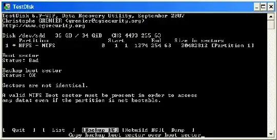

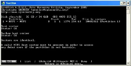

Now, the partitions are registered in the partition table. NTFS Boot sector recovery
The boot sector of the first partition named Partition 1 is still damaged. It's time to fix it. The status of the NTFS boot sector is bad and the backup boot sector is valid. Boot sectors are not identical. backup bs
To copy the backup of the boot sector over the boot sector, select Backup BS, validate with Enter, use y to confirm and next OK.
More information about repairing your boot sector under TestDisk Menu Items. The following message is displayed: after backup bs
The boot sector and its backup are now both OK and identical: the NTFS boot sector has been successfully recovered.
Press Enter to quit.

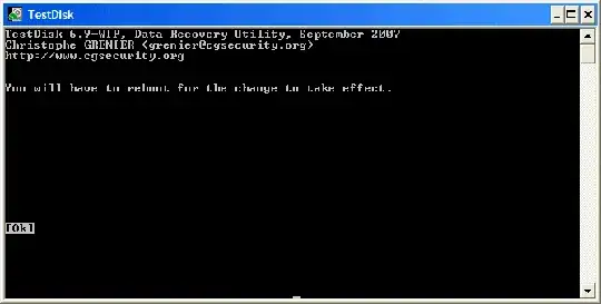

reboot
TestDisk displays You have to restart your Computer to access your data so press Enter a last time and reboot your computer.
