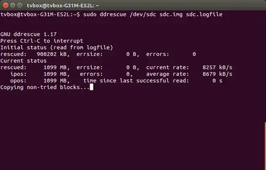

imaging will begin and you will see something like this:
ddrescue
Rescued indicates the amount of data successfully read, errsize indicates the size of unreadable data. As the process continues we hope to see the former increase and the latter approach zero. ddrescue uses a process called data carving as I recall in which failed blocks are halved and re-tried.
