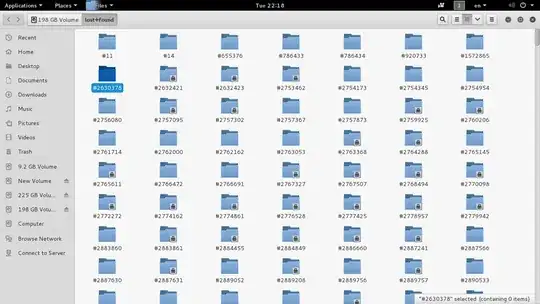

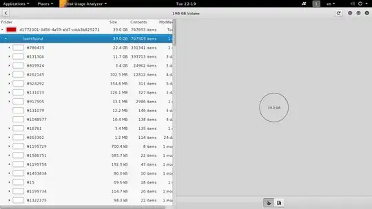

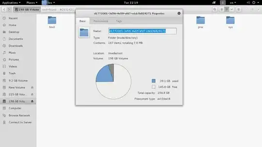

After using GParted my files are still there, but the filenames disappeared. My files are not deleted, the problem is my file names changed and the files are still there in the lost+found folder, and I can't install grub because I can't mount /dev/sda6.
  1. no grub
  2. no data
