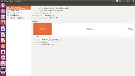

The only problem with this is that my hard disk had around 500GB memory, not 1800GB. So I decided to check what Disks say:
Disks

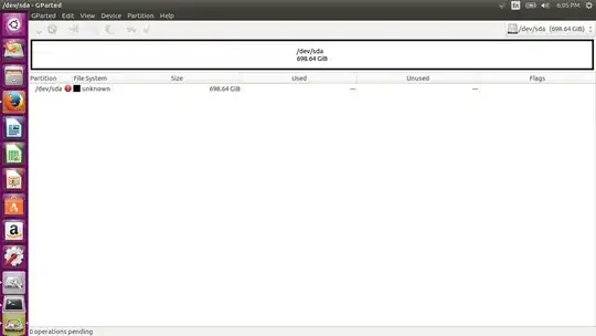

And here is what GParted says:
GParted
Now, what can I do to save at least the most important data (~200MB)? Can I solve this by resizing the partitions? It's crucial for me, so please help.
I am not sure where you got those numbers from, but the size of your hard drive is 750 GB.

You probably just need to recover the partition table. Most likely, the file system is not corrupted and you only have to tell the system how to find it.
However, it might also be that the file system is corrupted. I will discuss both alternatives.
No, absolutely not. Do not attempt to mess up the partitions before restoring the data.
