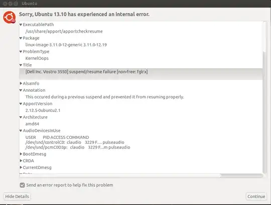

Back on 13.04 it didn't occurred. I've upgraded to 13.10, systems apparently working fine, but, when I put it to sleep(using or not using extended monitor) and try to wake up, I see the screen(both), without lock-screen, but completely freeze, Neither tty open, nor the keyboard works.
So, only option remains is to force shut-down. Any clue how to investigate the cause or fix it? Thanks in advance, any info that'll help you could ask!
Ubuntu 13.10 x64 - not a fresh install/upgraded - with Unity
Dell Vostro 3550
AMD Proprietary Drivers - 13.11 / Hybrid with Intel
--------------------- EDIT ------------------------
The fix has gone, i cant wake from suspend again, and, every time i shutdown/power up, i got like 9 windows from "report problem". this is the error:

Actually there is a bug which you can find in Launchpad.net
Best thing is that there is also a patch through which you can solve this issue.
Follow these steps hope it works for you also:
  • Open terminal and execute these steps:
    sudo cp /etc/default/grub /etc/default/grub_back
    taking the backup of original /etc/default/grub file, in case some error occurs we can get back to original state
    sudo gedit /etc/default/grub
    opening the file in gedit to make the changes.
    Once file opened replace following line :
    GRUB_CMDLINE_LINUX_DEFAULT="quiet splash"
    to the line:
    GRUB_CMDLINE_LINUX_DEFAULT="quiet splash pcie_aspm=force"
    Save the file Ctrl+S and close Ctrl+Q
Note: The next line to the line mentioned above should be GRUB_CMDLINE_LINUX="" not GRUB_CMDLINE_LINUX="acpi_osi=Linux"
  • Now execute following command to update the grub
    sudo update-grub
  • Re-start your system once.
Note: If you have trouble in brightness also and above method doesn't fix it then you can test by adding these lines in place I mentioned above.
2. GRUB_CMDLINE_LINUX_DEFAULT="quiet splash nomodeset"
or
3. GRUB_CMDLINE_LINUX_DEFAULT="quiet splash acpi_backlight=vendor pcie_aspm=force"
or
4. GRUB_CMDLINE_LINUX_DEFAULT="quiet splash acpi_backlight=vendor"
or
5. GRUB_CMDLINE_LINUX_DEFAULT="pcie_aspm=force"
or
6. GRUB_CMDLINE_LINUX_DEFAULT="quiet splash pci=nomsi"
Note: You have to do a sudo update-grub and a system restart every time you change the grub file
Different system would need different options, if any of the option works, I request to mention that in the comment.
Reply if something goes wrong..

When I installed fglrx on Saucy for my Radeon 6870, I experienced the same problem. I tried Saurav Kumar's method, but none of those boot parameters worked. From here, though, I found and tried adding "nomodeset" as a parameter, and I was able to resume from suspend normally.
Replacement of the Grub line with GRUB_CMDLINE_LINUX_DEFAULT="quiet splash nomodeset" was not enough for me.
At restart my screen resolution was downgraded and wakeup from suspend was still not working.
I had to change the video card driver from the "nouveau" (open source) to the NVidia (proprietary).
Altogether, it now works.

I had all kind of problems with that same laptop model and the 13.11 Beta proprietary driver, which by the way, states it is for Xorg/Xserver 6.9 and above (up to 1.13) and Saucy has Xorg version 1.14.
Anyway, almos all of my problems went away after running:
$sudo aticonfig --initial
Hope that helps...
