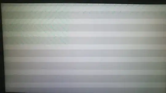

I tried the suggestion by Dima on this post How to enable hibernation?. The machine wakes up from hibernation but immediately the screen gives a screen like this
Wondering if this is an issue with the graphics card or something.
