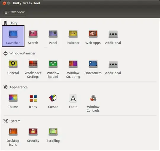

Now open the dash and search for "Unity Tweak Tool". It looks like this:
searching for unity weak tool in dash
Open it up and navigate to Launcher.
Unity Tweak Tool, main window (Overview)

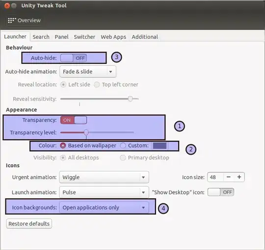

From there you can:
  1. Change the transparency of the launcher
  2. Change the color of the laucnher
  3. Auto-hide the launcher
  4. Or change the background for applications (This is closest to what you want I think)
    Unity Tweak Tool, Launcher tab

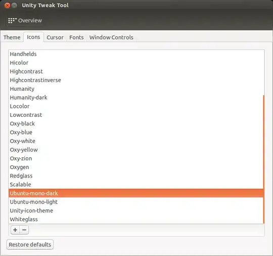

Another suggestion is changing your icon theme under Icons.
Unity Tweak Tool, Icons tab
You need to note however, you can't very well change icons of other applications.
Brightness is relative, but I got them this dark:
For certain icons, like the software center, you might have to change the actual icon, wherever the system stores it.
