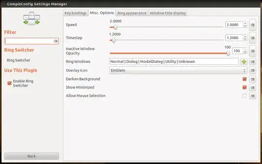

With Compiz, you can configure many ways for quickly change programs. You can make shortcuts to change programs at the Workspace in focus or at All Workspaces. You can define how fast you want it to work.
Remember to go to Misc Options to set the speed you want:

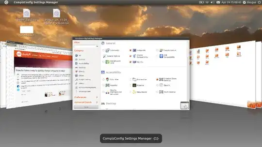

What I like most is "Swing Switcher":

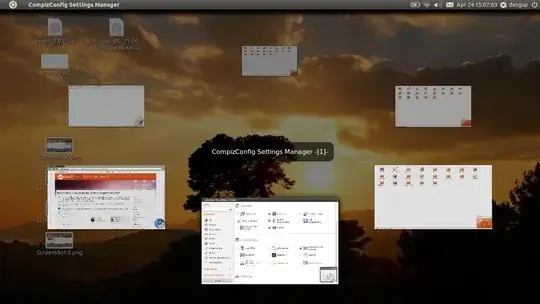

"Swift Switcher" is beautiful:

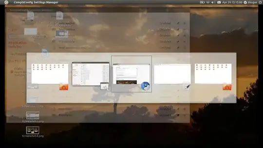

"Static Application Switcher" is simple but very useful:
