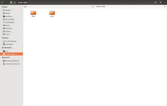

Workaround - Create a shortcut in Nautilus to the Trash folder in the drive desired in a new tab as seen below and manually deleting the folders files and info. I sincerely hope that someone can come up with a better solution while although this is a functional solution it is less than ideal. Trash
