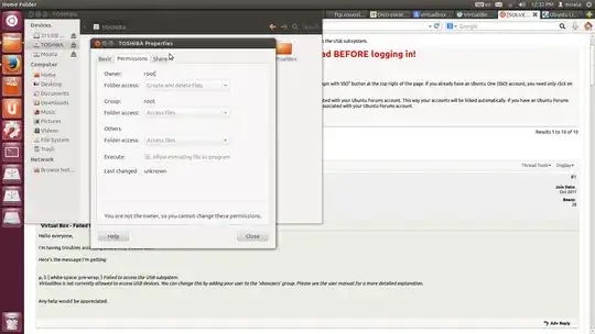

I have got an external hard disk TOSHIBA 1TB USB 3, the permission is always READ ONLY.
fdisk -l (output) :

How can I change the owner and permission of this hard drive ?
screenshot
