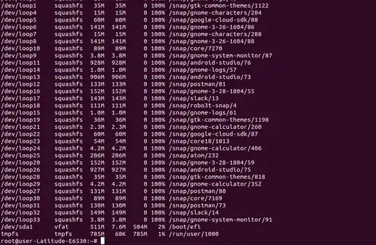

All you need is following 3 commands.
  1. df -Th
result - enter image description here
  1. umount /media/user/KINGSTON (this is mount on path)
  2. dosfsck -a /dev/sdb1 (this is Filesystem path)
