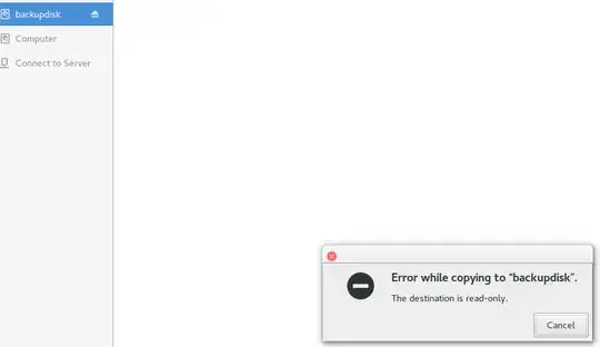

On Ubuntu 16.04 LTS with a 500GB external WD Hard Drive.
After formatting to NTFS, I can not write files using the graphical Files explorer, I get the pop up error seen below:
Pop up error copying files:
I've tried the following:
$ sudo apt-get purge ntfs-3g
$ sudo apt-get install ntfs-3g
This reinstalled the ntfs-3g tools. Great, but I still can't do anything. Here's the out put of ls -al /media, sudo fdisk -l and cat /etc/fstab

I believe you have to remount the partition/disk in read/write mode. I had same problems with one of newly created partitions. Try
sudo mount -o remount,rw /PartitionID /MountPoint
Enter the right PartitionID and MountPoint.
muru
  • 207,228
After a lot of attempt I solved the issue this way:
you can find the partitionID with command sudo fdisk -l. The id looks like some random number. And MountPoint is the location of your drive. Usually resides in /media/user_name/. Even if after that you can't write, you might need to change the permission of writing using chmod sudo chmod u+w myfolder.
I had the same issue, I fixed it with:
ntfsfix /dev/sdb1
Replace sdb1 with your partition's ID.
