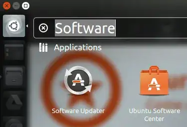

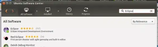

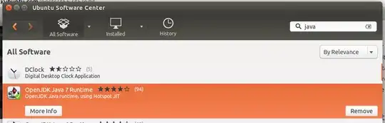

  • Search Software on Ubuntu and launch Ubuntu Software Center
    Searching

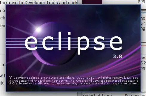

  • Search Java on Ubuntu Software Center and then install the OpenJDK Java Runtime.
  • Search Eclipse on Ubuntu Software Center and then install it.
  • If you have successfully installed eclipse and JDK, it will appear in the search result on your computer.

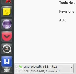

2. Downloading SDK

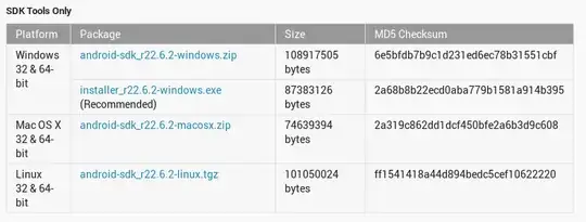

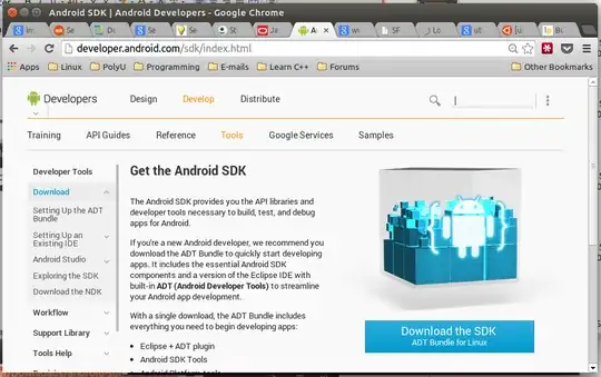

  • Go to http://developer.android.com/sdk/index.html to download the latest version of SDK. enter image description here
  • Scroll down and click DOWNLOAD FROM OTHER PLATFORMS enter image description here

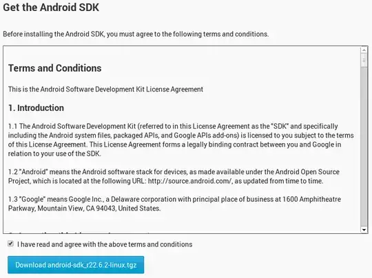

  • Click android-sdk_r22.6.2-linux.tgz under Linux 32 & 64-bit of SDK Tools Only.
  • Tick I have read and agree with the above terms and conditions and click Download android-sdk_r22.6.2-linux.tgz.
  • Wait for the download process.

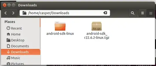

3. Preparing for Installation
  • Go to the location where you set to download the file.
  • Rigth click the file[.tgz] and select Extract Here.

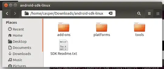

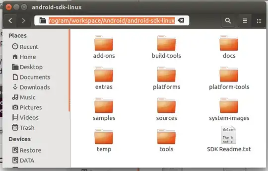

  • Now you can see that a file called android-sdk-linux appears as if the following.

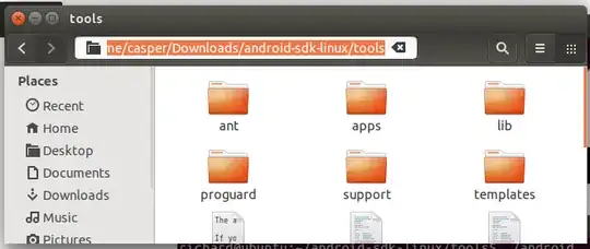

  • Enter the folder android-sdk-linux.
  • Enter the folder tools and then copy the folder location.
  • Press the keys CTRL + ALT + T to open a terminal and then use the following command. Where /home/casper/Downloads/android-sdk-linux/tools is the location I copied previously. You can just type cd and right click to past the location to the terminal.

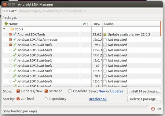

  • Now the Android SDK Manager will be run.
4. Installing Packages

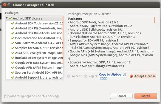

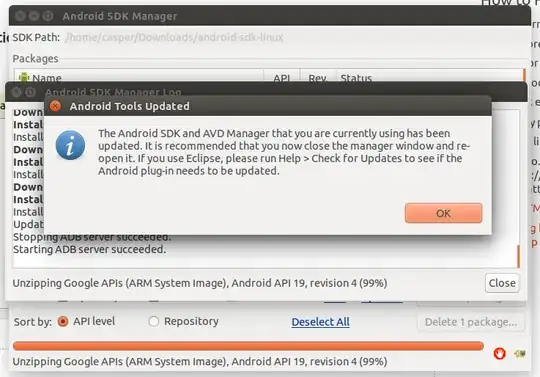

  • Click Install [Number] packages....
  • Click Accept License and then click Install.
  • Wait for the installation process.
  • Finally, this message will be shown.

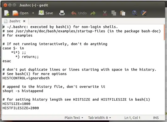

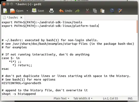

5. Editing ".bashrc"
  • Press CTRL + ALT + T to open a new terminal and type : gedit ~/.bashrc
  • Now the following text will appear.
  • Add the following to the top of the entire text and then save it. (Do not close the file)
        export PATH=${PATH}:~/android-sdk-linux/tools
        export PATH=${PATH}:~/android-sdk-linux/platform-tools
  • Example :

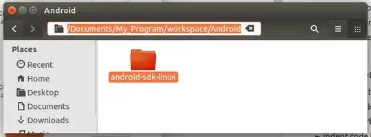

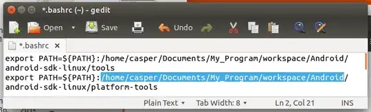

  • [Recommended] Move the whole file android-sdk-linux to your eclipse's workspace and under a folder that you create named Android. Moreover, you have to copy the location.
  • Now back to the ".bashrc" file and the replace the '~' with the location you copied previously and then save it and close it.
  • Logout and relogin your Ubuntu system.

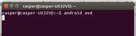

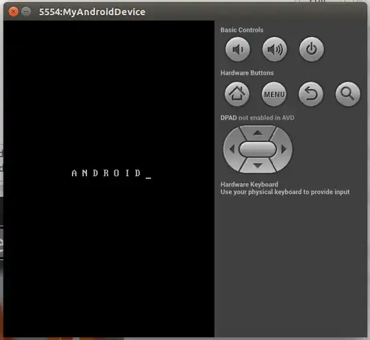

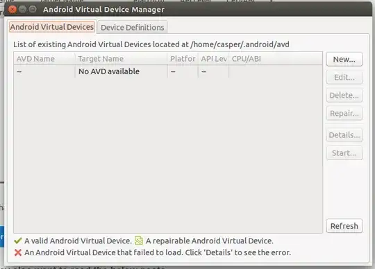

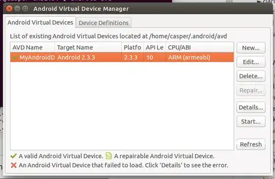

6. Setting Up an Android Virtual Device

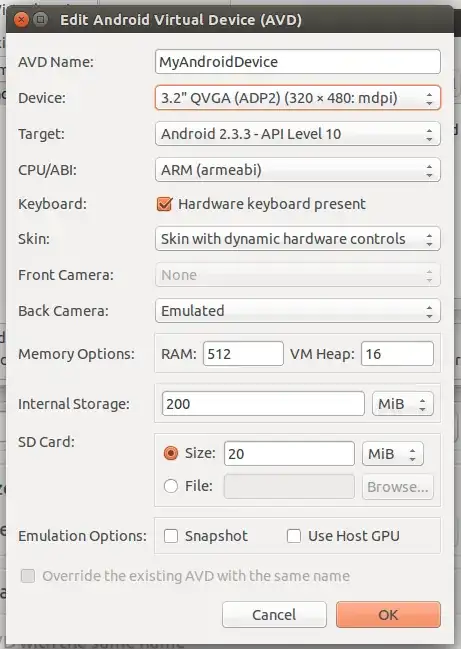

  • Press CTRL + ALT + T and type android avd to open the Android Virtual Device Manager.

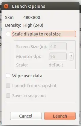

  • Click New.... Set up like the following and click OK.
  • Click your virtual device and then click Start....
  • Click Launch.
  • Launching your virtual device enter image description here

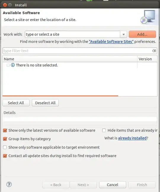

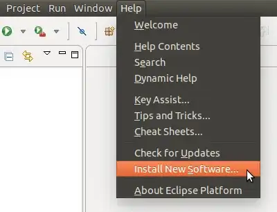

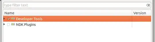

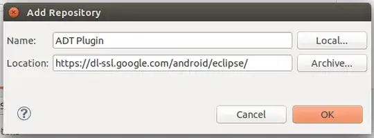

7. Installing ADT Plugin on Eclipse
  • Start Eclipse and go to Help -> Install New Software...
  • Click Add....
  • Type the following and then click OK.
     Location :    https://dl-ssl.google.com/android/eclipse/

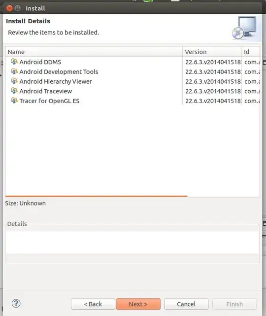

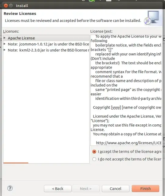

  • Tick the checkbox of Developer Tools and then click Next>.
  • Click Next>.
  • Click "I accept the..." and click Finish.

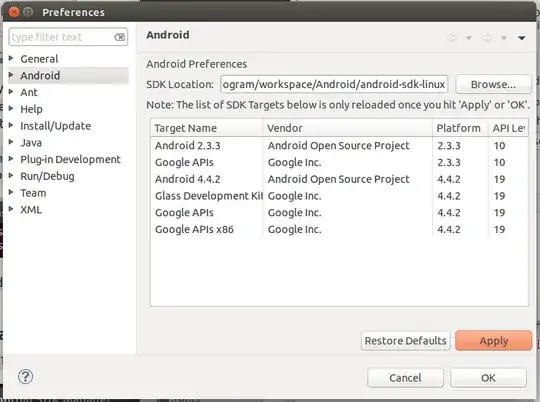

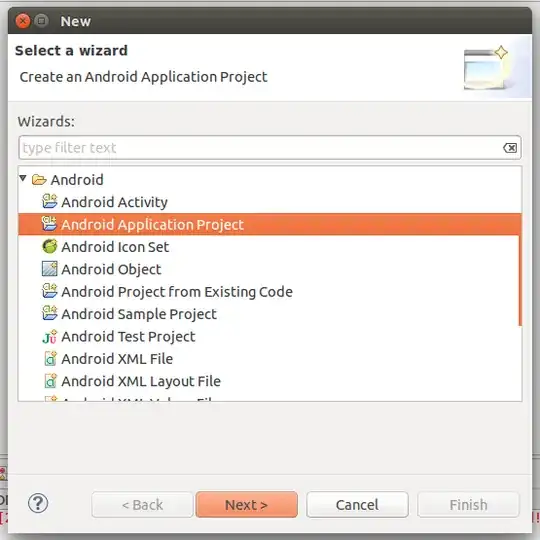

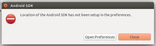

  • Click Open Preferences.
  • Copy your own SDK location (The location of the file android-sdk-linux).
  • Paste to the SDK Location: textbox and then click Apply and OK.
  • Enjoy to create any android application with your Ubuntu.
