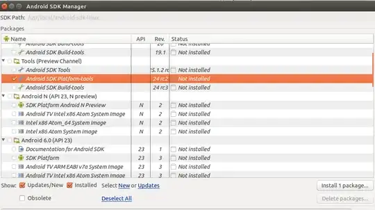

I am planning to install Android SDK for my Ubuntu 15.10. I downloaded the latest version of SDK, uncompressed and put it in folder /usr/local/android-sdk-linux with folders add-ons, platforms, tools. But I could not find Platform-tools. For install same I try Android SDK Manager using command:
$ android
And try to install Platform-tools only like below:

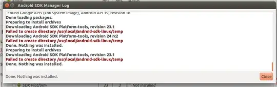

I got the following error:

From IRC channel ubuntu I got solution. Thanks , and .. According to them download the sdk on /home (~) and do the following stuff make the problem finished
wget http://dl.google.com/android/android-sdk_r24.4.1-linux.tgz
tar -xzf android-sdk_r24.4.1-linux.tgz
cd android-sdk-linux && ./tools/android
then my android sdk manager not shown any error...
Advise: Don't put sdk library in any other path than home of a user..
