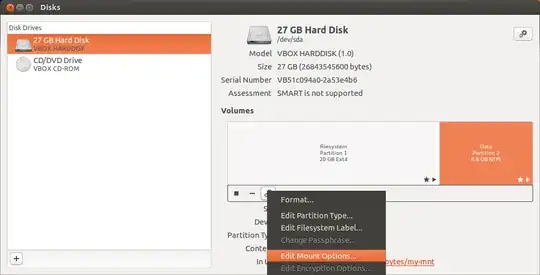

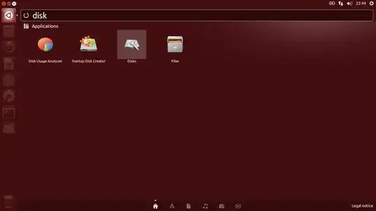

Type Disks in Dash, and you will get:

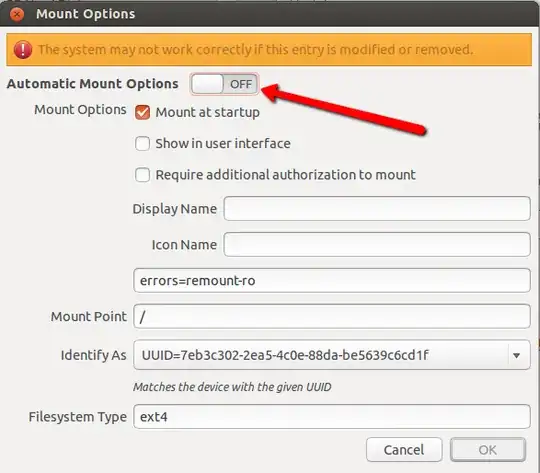

Click on the little gears icon, to get the sub menu, and choose Edit Mount Options. After that you will see:
Change the Automatic Mount Options to ON. do that to all the drives that you need mounted on start-up.

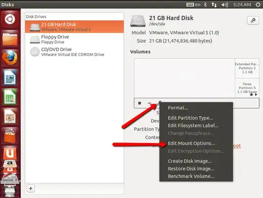

Press the Ubuntu button, start your disks application.
disks

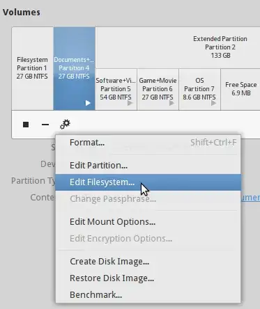

select your NTFS Partition/Disk? Press the configuration button select Edit Mount Options...

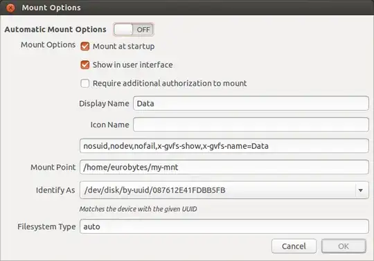

Edit Mount Options
Turn off the Automatic Mount Options, select Mount at startup. choose your Display Name Like Data or partition-Data or seriously-not-porn, whichever best describes your personality?!
Mount Options window
Mount Point means where do you want it to be mounted! this could be /mnt/DATA//home/username/part-data or /home/username/Videos/no-porno again, what best describes your personality! After that Press OK, type in your password, again OK. and restart your system, and see your mounted HardDiskdrive.

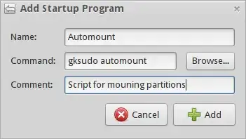

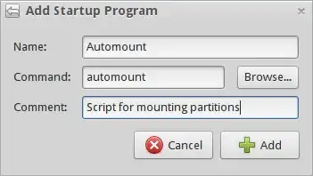

    Then create Startup Application (gnome-session-properties) and add the following:
screenshot

Then create Startup Application (gnome-session-properties) and add following:
screenshot2
Note: For running gksudo, the package gksu must be installed. If not, first do: sudo apt-get install gksu

In the "Mount Options" window, be sure to UNCHECK the "Show In User Interface" option if you make changes using this utility. There is a KNOWN BUG that can cause the mounting to fail and even make your system unbootable if you use the DISKS utility to change these options and leave "Show in User Interface" checked.
That bug will show up as stating that the commend "x-gvfs-show" is not recognized or that there is a parameter missing when trying to mount that partition.
